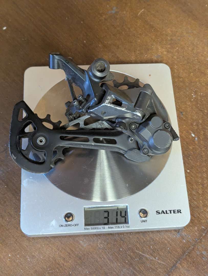

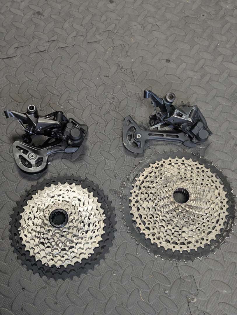

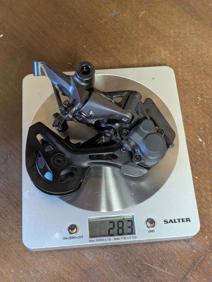

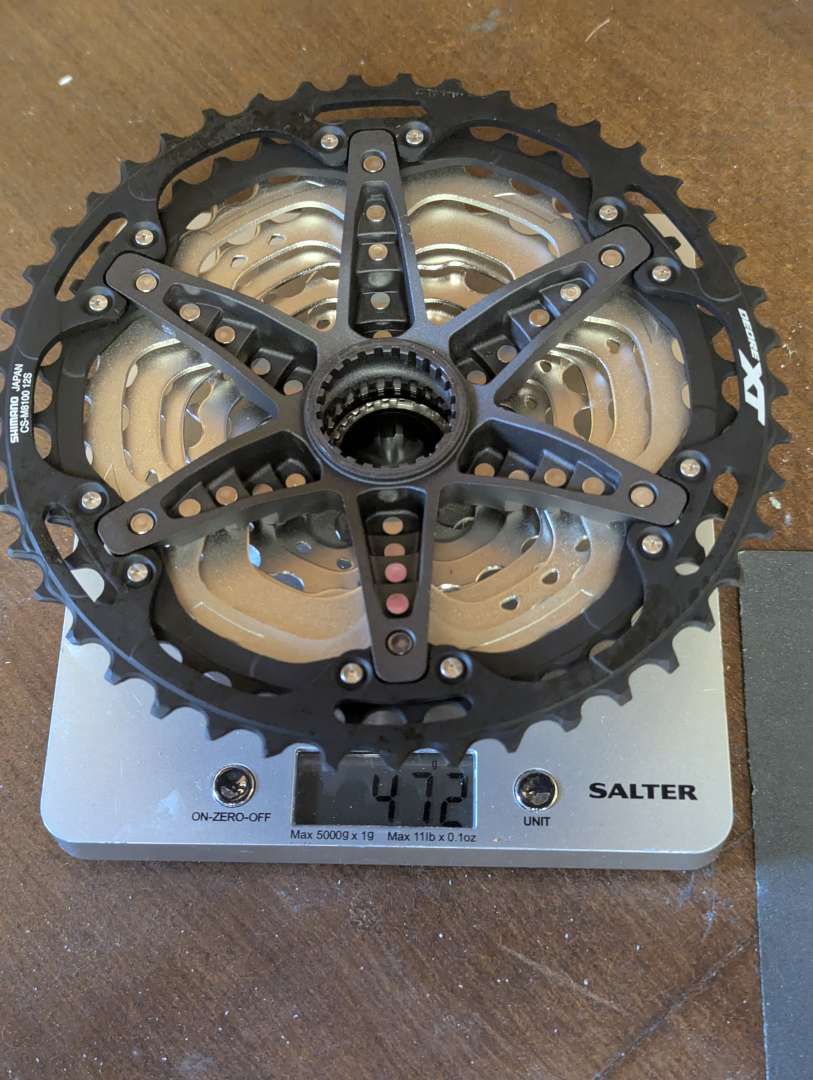

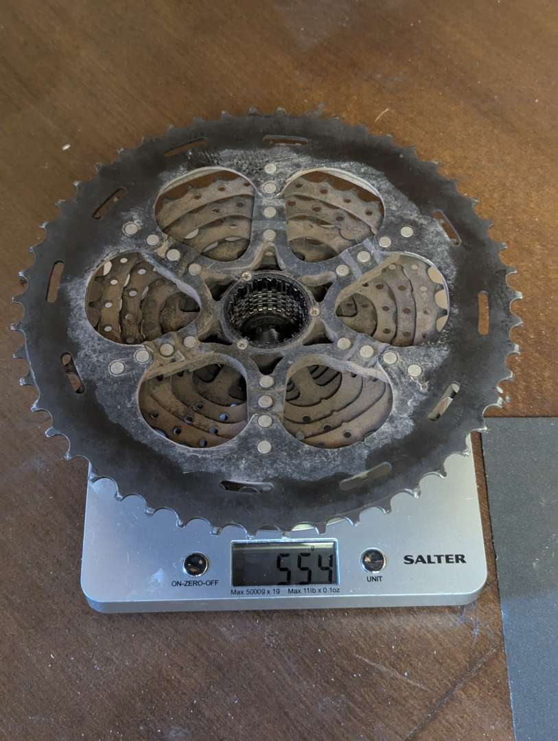

I've never really weighed bike parts before. Is this how weight weenies live?
Anyway, as you can see I've shaved a grand total of 113 grams from the rear axle.
This is the cheapy unbranded 10-50 which came fitted to a Privateer 141.
This is the new XT 10-45. The difference is really obvious just when handling them.
And as an added Bonus, the XT derailleur is a fair bit lighter than the SLX.
Not to mention the whole lot just looks a lot nicer, and much tidier on the bike. I've never been a fan of giant cassettes.
I haven't ridden it yet. I've got some chain alignment issues to sort out related to the new Hope cranks and Rimpact chainring. If I get that sorted this week there will be a test ride on Saturday.
I think I said above that this is for my bikepark/uplift/Alps bike so ultimate pedalling ability isn't really a concern. I'd rather have the lower weight and extra clearance. I did consider fitting a 7 speed DH setup but that would be a step too far. Maybe next time.

I've literally got both setups next to each other on two of my bikes - M8100 XT with long cage and 10-51t cassette, and M8100 Xt with medium cage and 10-45t cassette.
They have exactly the same features and design, they just have a different cage. And I am 100% convinced that the 10-45 shifts better, faster, more accurately, doesnt bounce about as much etc - all you lose is range (and weight!).
And I'll double down on what I said earlier, simply changing to the smaller cassette is sub optimal, the b-tension and cage geometry is never quite right, and it either shifts well at the top end or the bottom end, but never the whole 12 ratios.
Using the matching shorter cage mech with its associated cassette made an instant improvement (Shimano do not list them as cross compatible).
I'm very excited to see what becomes available with the new XT with an ultra low profile, wireless mech and a 9-45 ratio. Slim, light, out the way from rocks etc, it could be brilliant.
