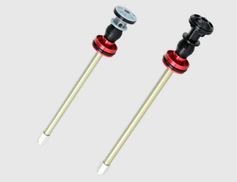

Posts: 7915
I've not opened anything younger than 2017, but the spacer length under the air seal was longer on the Lyrik air shaft compared to the Pike. Both 150mm.
You can see the difference in spacer length below comparing the grey piston head and the black piston head.
pistons
TBH they make so many running changes its difficult to keep up.
Posted : 08/08/2022 11:45 am
Fair do's what's the actual shaft difference (if anything)? (If you have them to measure) .. looks like you could easily swap the seal head over or just stick 2 top out bumpers on the shorter (Pike?) one?
Posted : 08/08/2022 1:09 pm
Posts: 7915
I never measured it, but I'd say about 10-15mm longer. I can't measure them now that I'm running Fox!
Incidentally, fox also space out the neg spring differently on the 36, but that appears to be related to travel.
