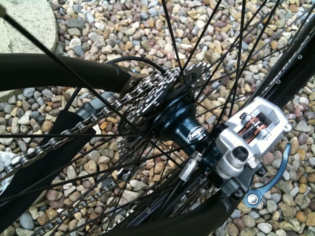

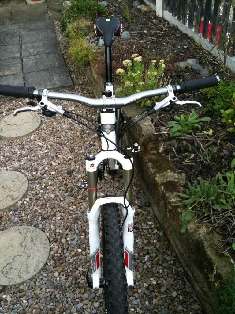

What the heck - more pics and spec:
Frame: White Medium PACE RC405 (adonised rear triangle)
Forks: 2010 Rock Shox Revelations Team Dual Air
Shock: DT Swiss M210
Brakes: Avid Elixir R (185mm Front, 160mm Rear)
Stem: Sunline XC
Handlebars: Sunline 711
Headset: Hope "The Headset"
Grips: Sunline Lock on
Shifters: Shimano XT
Front Mech: Shimano SLX (Double)
Rear Mech: Shimano XT
Crankset: Shimano SLX Double and Bash
Pedals: Shimano XT
BB: Pace RC80
Rims: Mavic 719
Hubs: Hope Pro 2
Tyres: currently Bonty Mud X 2.1's will switch to Nobby Nics in Spring
Seatpost: Thomson layback
Saddle: SDG Bel Air
Weighing in at a shade over 12kg (sub 30lbs - get in!!!)
Posted : 05/12/2010 2:29 pm
