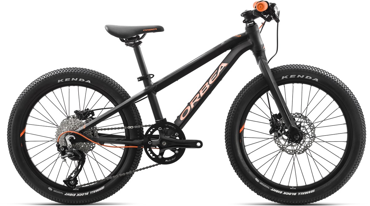

Orbea do really nice kids bikes.
https://www.orbea.com/gb-en/bicycles/kids/mx-kids
Posted : 07/08/2017 9:41 am

Orbea MX20 does look the best on paper - much better specced, better looking and far cheaper than an Islabike though the residuals* are probably not quite as good.

Got my daughter an orbea MX20 for £150 on ebay the other week, immaculate
She loves it, and I'm quite jealous, it's a lovely little bike, great matt black/pink/blue/yellow colourscheme (that's the bit that important to kids)
The internal cable routing is better than any of my bikes have had, frame is beautifully hydroformed and light
Even has little bosses on the down tube for a crud catcher type mudguard (yet to find one small enough though) and a nice little CX style chain catcher to stop the chain coming off, cranks, brakes, grips etc are all child sized just like on Isla or Frog
My daughter got the hang of gears before she even got to the end of the street and finds them light enough to change no problem and I can't get her off it now
She had a 16" Frog before which I sold for £30 less than what we paid new, after over 3 years, so the Orbea ended up costing me £20!
Bike is so nice in fact I would seriously look at orbea for my next bike, if the adult ones are as well thought out they have to be worth a look

@ Iain1775
Any chance you could weigh the orbea MX20 please?
Which one did you get? Team disc looks nice.
Posted : 04/10/2017 4:21 pm
Goldigger
Just bought my lad an MX team (non disc) last week.
Its bang on 8.5kg on the luggage scales.
I've put a smaller 40mm stem on to reduce the reach.
I'm really impressed by it tbh.
Posted : 04/10/2017 5:10 pm
Cheers, that's good news I was hoping it was no more than 10kg. As it's lighter even better.
Is there plenty of room for a bigger tyre? Stock is 2.1?
There's some kenda 2.6 20" tyres but think there only OEM.

Went for the orbea team disc, it was cheaper than the commencal.
Main reasons I went for it are:
1.Tubeless rims
2.Cassette is a freehub rather than freewheel screw on, so option to fit a 9spd cassette/shifter out of the parts bin.
3.Shimano Hydraulic disc brakes rather than cable actuated ones. Read numerous reports that the tektro cable disc brakes are crap.
Will probably chop a carbon bar down and fit that.
Posted : 26/10/2017 8:23 pm

Here my lads orbea team disc mx20
Only thing I don't like on it is what appears to be a long cage rear derailleur.
Is there a short cage 9spd derailleur that I could replace it with?.. something like the Zee 10spd.
That cage is great at picking up sticks and all sorts and jamming up the jockey wheels.
Posted : 12/11/2017 7:21 pm
older 105
Posted : 12/11/2017 8:19 pm
