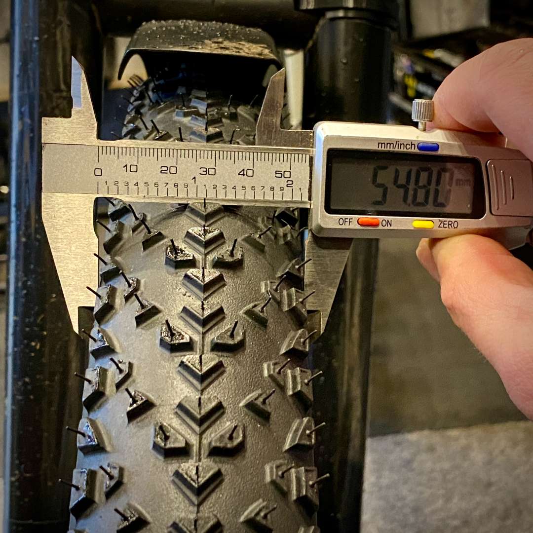

I don't know about XC tyres being more supple sidewalls than gravel tyres but I see the logic.
I swapped from 700x50 Clement X'Plor gravels to 29x2.2 Conti Race Kings in 'Performance Shieldwall' variety (not the cheap wire bead ones but also not the expensive ProTection ones). The Clement 50mm/2.0 actually measured at 54mm vs 54.8mm for the Conti 2.2 on the same 25mm internal rim, but the volume/height is greater and the more knobbly tread adds width.
If anything I'd say the Conti sidewalls appear to be more robust but it also feels slightly more supple. I'm also riding a few psi less so it's not that clear cut, but the robust appearance of the sidewall is what encouraged me to try slightly less pressure (I ran more pressure in the Clements as they felt quite flimsy).
I imagine the 50mm/2.0" version of the Race King will be a decent tyre also. I'm happy with my 2.2s.
