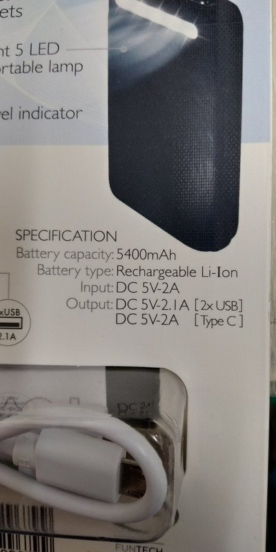

I actually sell these in my shop. Would this charge my diablo?
Posted : 06/11/2019 10:01 am

I used the battery pack I pictured above to charge my Joystick. It charged it really quickly but once the green light came on the front light started flashing even though it wasn't turned on .  What does that mean?
