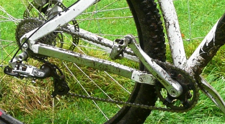

With these 1x9 set-ups you really need to go as short on chain length as possible
Check out this pic. The chain is not on the 34 either
No drop devise. Chain NEVER drops
