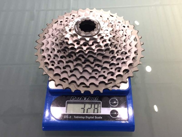

XG-1175 Full Pin Cassette – 325 grams – $144, €150, £115
11sp 11-40 XTR
