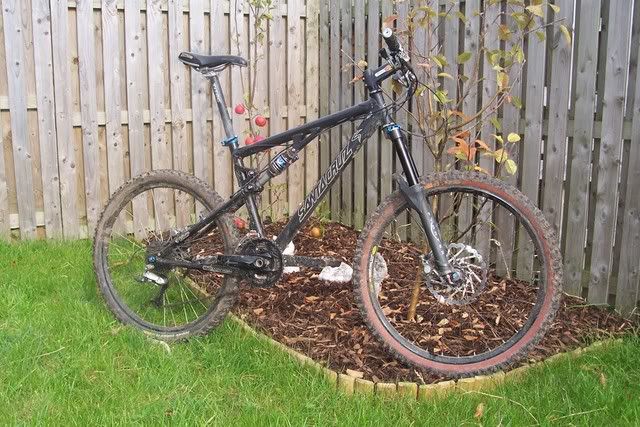

Ran mine at 150mm for 2 years with no bother, went to the north wales trail centres, les gets, peaks etc as well as the normal irish stuff with no bother - only got rid because I had a chance to get a LRS which needs bearing once a decade and is faster...
[img] ?t=1306161279[/img]
[img] ?t=1306161348[/img]
