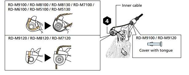

Does the cable go anti-clockwise as it goes into the pinch bolt? If clockwise, it’s in the wrong position leading to shifting issues. A common mistake, apparently.

As mentioned above, check the cable at the mech is routed as shown in the Shimano guide. Deore 12 speed is RD-M6100
M7100
Posted : 13/02/2024 7:09 pm

Got a alignment tool on the way, but thanks for offer. Cable all correct. Thanks for all the tips
