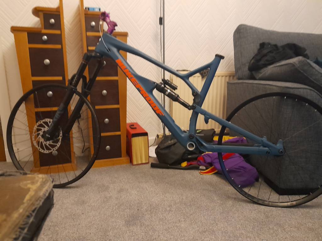

The project in question.
mega 275
Posted : 01/08/2023 9:15 pm
Posts: 2324
That looks very pretty, but obviously the lawn needs cutting and the pointing doing😜
