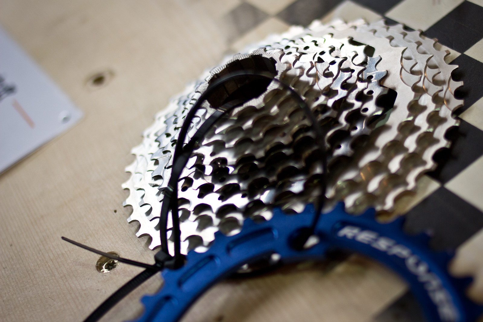

[url= http://www.trickstuff.de/en/news/news_archiv.php ]Trickstuff[/url] 11-40 tooth cassette.
It does, or will exist (may be an 11-41T) , but it's spendy mind.
[url= http://www.vitalmtb.com/photos/features/2014-Mountain-Bike-Components-at-Eurobike-2013,6299/TrickStuff-11-40-Tooth-10-Speed-Cassette,63197/bturman,109 ]Article here[/url]
[img] ?1378260188[/img]
Posted : 25/05/2014 5:26 pm

looks perfect the response cassette, not cheap but gives the near range of the 11 spd stuff without a cassette, freehub body, shifter, mech change/cost
