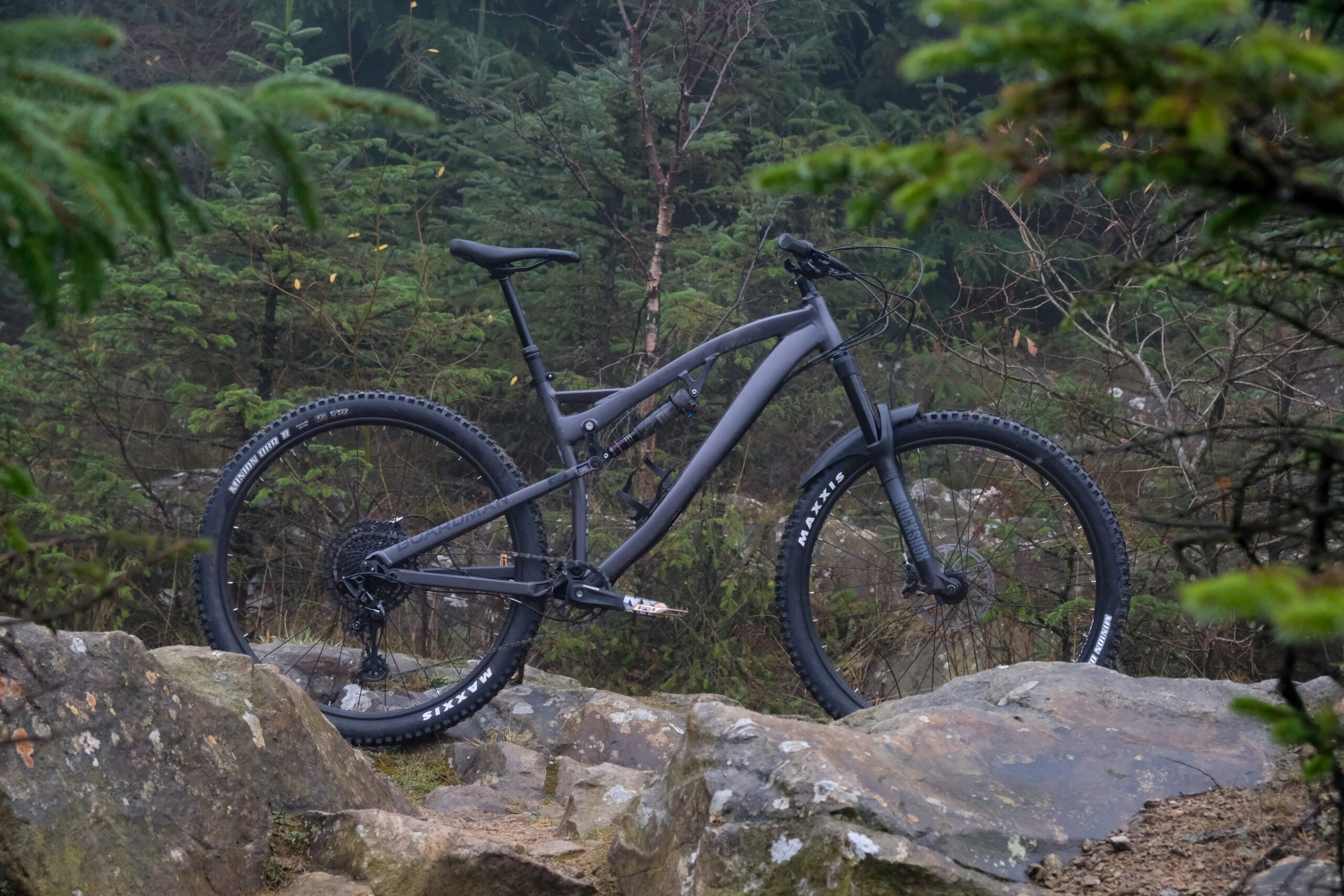

The Boardman is essentially a Halfords own-brand bike named after Chris Boardman, the erstwhile road time trial and velodrome legend from the previous century. Both of these facts instantly put the MTR 8.9 onto something of a back foot when it comes to kudos from the off-road cognoscenti. Dirtbags like ‘cool’ brands with ‘pure’ MTB heritage. A roadie brand from Halfords (of all places) just doesn’t cut it.
You will very rarely hear an experienced mountain biker recommend a Boardman bike if someone asks them ‘what’s a good mountain bike to get’. Is this snobbery justified? Let’s find out.
Lengthy (230 x 60mm) rear shock
The Bike
The matt black… er, everything on the Boardman MTR 8.9 is either ‘tasteful’ or ‘boring’, depending who you ask. One thing’s for sure though, it does help the MTR hide its slightly old-fashioned silhouette. The tubing of the MTR gives it the look of a mountain bike from ten years ago, when hydroformed front triangles were in vogue and the rest of the tubes all looked like they came from different suppliers.

But this is all cover-of-the-book judging isn’t it? The rather dated appearance may be one of the reasons this bike doesn’t charge nearer £2k. Leaving aesthetics behind, let’s talk about the more important stuff.
Vital stats
The rear suspension is a trad four-bar – pivot on the chainstay and all – with a swing-link driving the shock mounted to the top tube, delivering a generous 145mm of travel. All of the cabling, bar the final section of dropper post, is externally routed. Which, again, some will think makes the bike look ‘old’ but others (like us) will be pleased to see because internal cable routing makes life harder than it needs to be for most folk.

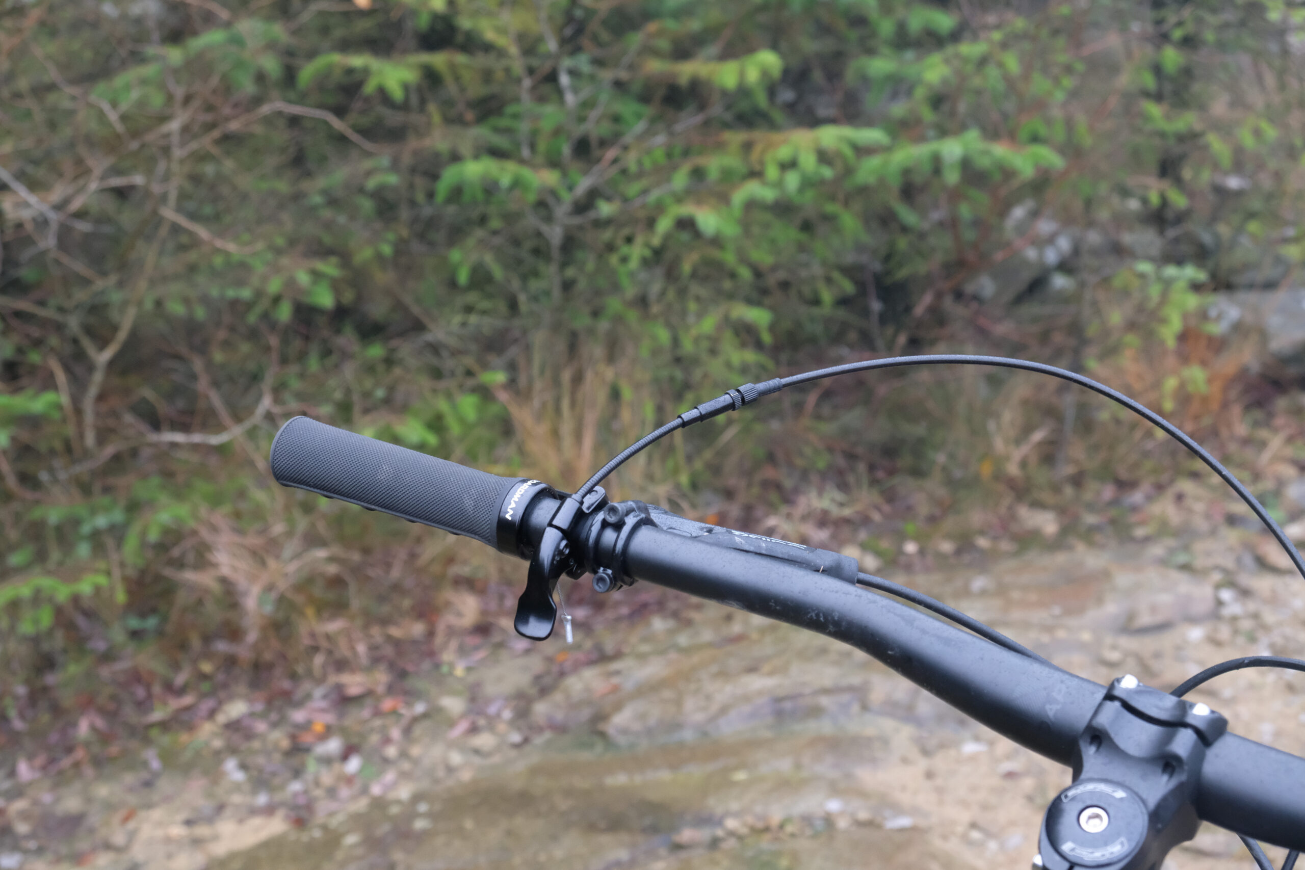

Old school dropper remote

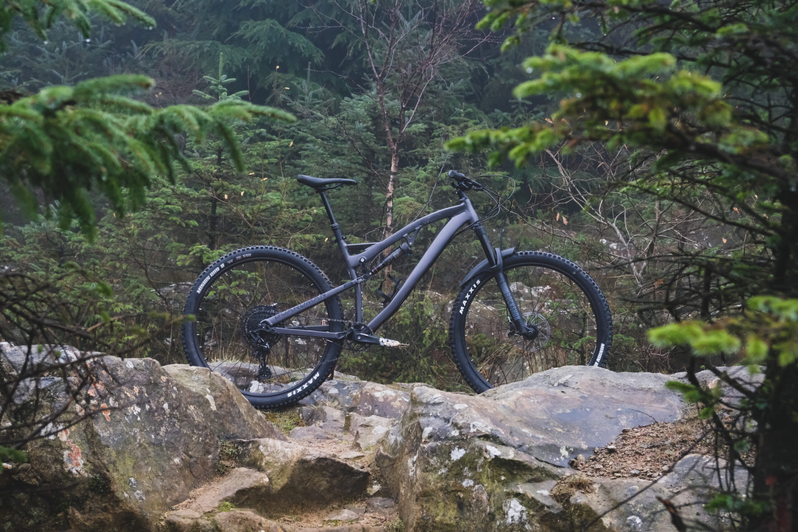

Perhaps the most impressive aspect of the Boardman MTR 8.9 was its suspension performance. The RockShox Gold 35 fork is great. It never felt overfaced across rough stuff, or noodly or binding-y under hard braking. Four-bar designs can be overly squidgy, vague and collapse-y if not done well, but the rear suspension here is properly sorted. Sorted so much that it is ‘invisible’ and consequently very easy to totally not think about during riding.
The MTR feels nicely supple and grippy when climbing or cruising, but quickly asserts a nice level of support and feedback when things get faster and/or rougher. It does as much as you need it to, when you need it to. Nothing excessively active or unpredictable. The rear shock itself is a lengthy 230x60mm unit and its generous size no doubt helps its capability, ease of set-up and overall predictability. It is a seriously impressive rear suspension design that wholly offsets any concerns about how retro the frame tubing itself looks.
To turn closer attention back to the components, because they can make or break a bike at this price point, we can spot two easily overlooked items. One good, one bad. The bad: the vertically orientated dropper post lever is hard to go back to when you’re used to shifter-style horizontal levers. The good: 30mm internal width rims will work fine with modern aftermarket tyre purchases. And while you run the tyres that the bike comes with (which you should do because they are great all-rounders) all you need to make them tubeless is a set of valves and some sealant because the rims and the tyres are tubeless-ready.
