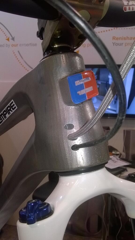

Though it is super mega wicked awesome, that head badge is a disaster area. Still, super mega wicked awesome.
